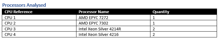

@stephengd80 I like the build. EPYC is the way to go for video compression, rather than dual Silver Xeon. Benchmarks on the video compression SPEC17 benchmark attached for EPYC vs Xeon. Regards RAM, I'd say to switch to Quad channel, it'll benefit the Infinity Fabric on this platform.
