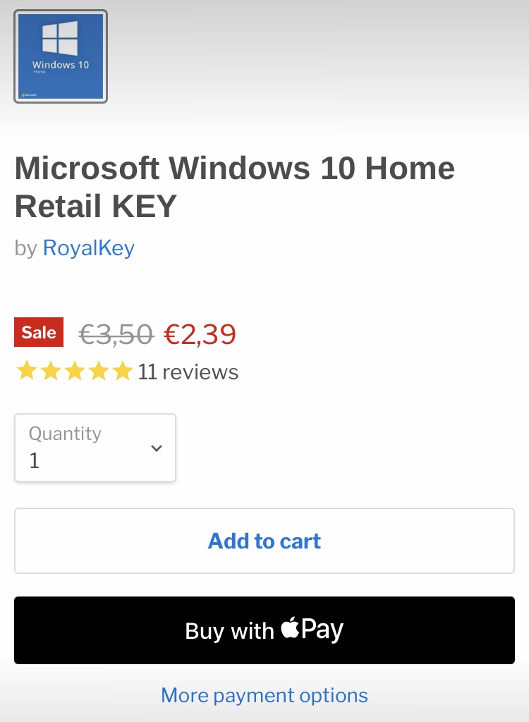

We need to know where you got the key. Please confirm where it came from.
A site called RoyalKey. I don't understand how that would affect this. It comes on after a few restarts then it goes off again - it seems it is more faulty and I have installed the drivers from Intel and it still isn't working/showing.

@VirtualYoda888 I would strongly recommend double checking if your windows is actually licensed, this seems very dodgy.

I do not belive that this is a legal key. Microsoft do not make Windows keys available at that price.
The Web is awash with hookey keys and unless you have proof that it's a genuine Microsoft key we'll have to assume that it's illegal.
We cannot assist you if you're using an illegal key I'm afraid
