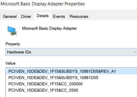

The only other thing I can think of is that it uses the desktop driver.
What is the hardware ID of the GPU? Can you install the chipset drivers just now and possibly get the Desktop version of the Nvidia driver from your phone?
hezzlington
That's a really strange one. Can't even find anything for that HWID.

More searching has found that it's a MSI GPU.
Apparently ASUS has the same card. I would probably give that driver a go if there isn't one available from PCS. It seems that particular driver package is OEM only, hence why you can't see it on the Nvidia site.
im confused, how come its MSI when it says on my order that the GPU is Nvidia?
