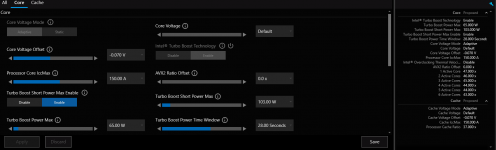

My laptop has been working perfectly since the last time I posted here. However, I decided to do a fresh reinstall of Windows the other day using the Creation Tool and everything went smoothly. I allowed windows to update the system with the latest drivers, and any software or drivers that were missing, I downloaded from the PCSpecialist Download page (mainly just Creative Sound Blaster).
However, the past few days I've noticed my framerates are unable to sustain the usual consistent 144+FPS in certain games. In games such as Overwatch and Apex Legends, I was able to achieve the usual 144+FPS until the last couple of days, where it'll drop to 80s-120s at times. I was curious what the problem was and decided to check out Intel XTU and stress test my CPU.
After 58 seconds of performing a CPU stress test, I noticed my laptop was "Power Limit Throttling" despite no changes to my core + cache. During the stress test, my CPU never reaches higher than 74 degrees either. Additionally, my CPU is still receiving excellent overall thermal performance and very rarely goes higher than 80 degrees during gaming (GPU also has excellent thermal performance).

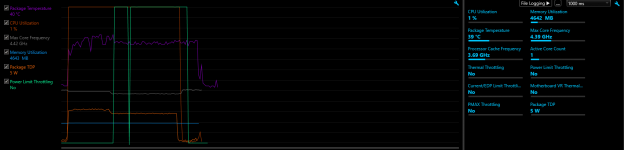

How much is the CPU actually throttling? Does it just hit a plateau or does it pull back some frequency when the Power Limit triggers?
DarkPaladin
I added a stress test (roughly 2-3 minutes) to show what happens when the CPU begins to power limit throttle.

That indicates the Package TDP at 5W - I assume that is the power draw when you took the screenshot after the test, but it still seems very low for your CPU even at idle.
Can you see what the package TDP or Package Power peaks at during the test?
DarkPaladin
Can you see what the package TDP peaks at during the test?
The package peaks at around 75TDP before throttling down to the 60s.
Not sure if it's worth mentioning, but I bumped up the Turbo Boost from 65W to 75W and had no throttling after the 5 minute stress test. I'd rather not resort to increasing the power consumption for an issue that never used to happen at those settings though.

Definitely. These were screenshots from when I first received my laptop back in 2019:
The below screenshots are from today:
The only difference from those screenshots is that I decreased the undervolt from the default -100 to -0.70 shortly after receiving my laptop.

Decreasing the undervolt would increase the power draw but of course that doesn't explain why you are only having issues now if you did that a year or two ago. Have you tried returning the undervolt to what it was originally out of interest?
(All your setting look identical in your post abive - bar the undervolt of course....)
NoddyPirate
Grand Master
The only other thing that seems to possibly work is setting your Turbo Boost Short Power Max to the same value as Turbo Boost Power Max - so both at 65W. Might be worth a try just to see the difference?
If your TDP is peaking at 75W anyway it doesn't sound like changing it would impact performance in any meaningful way.
