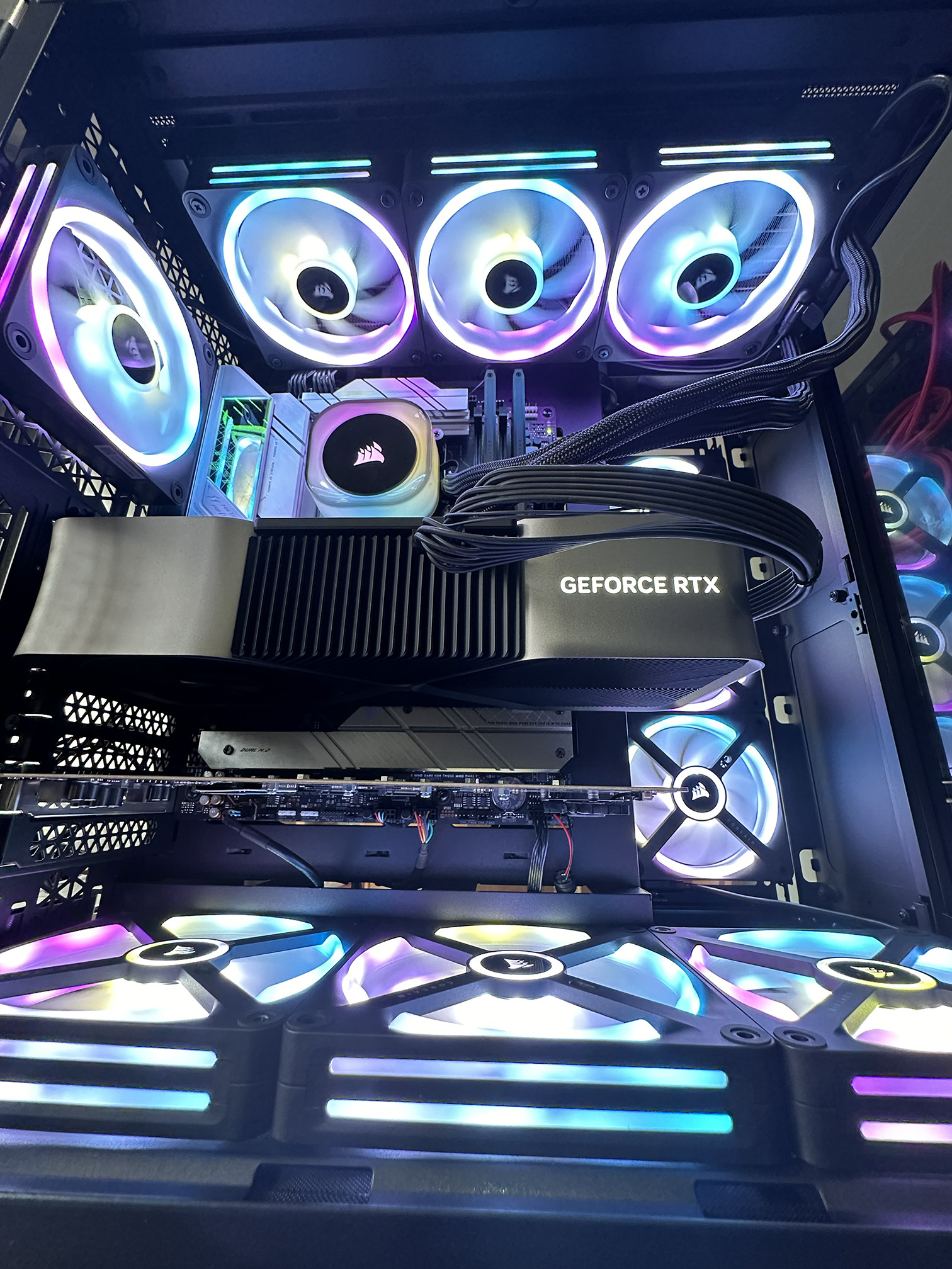

More does not necessarily mean better...as it needs to be balanced. Otherwise you just create noise from over-pressurising the air in the case.
You'll have 3 front intake, 1 rear exhaust and 2 top exhaust, so it's nicely balanced. Of course there may be some fan adjustments needed to get the cooling/temps/noise levels exactly where you need them, but that can't be done beforehand.
...and after saying all that, I've got 6 intake and 4 exhaust, but I've got the 6 intakes on very low speeds so that they're silent but give the same airflow pressure as 3 intakes running at higher speeds. 3 on the bottom blow directly onto the 4090 GPU, and the 3 at the side just bring in air to the whole case (a 6500X case).
The lights on mine (picture is just from initial set-up) are currently set to give me temp warning (blue below 60ºc, yellow to 75º, then red). Only seen them at blue or yellowy-blue so far...and I'll probably change them to a 'prettier' effect once I'm happy I've got the cooling where I want it.
