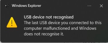

Hi all. My Seagate expansiopn external HDD has developed a fault and sometimes (not always) just shows me this error message (please see attachment) so I guess I need to look for a new one. Any suggestions for a 4TB or thereabouts external?

Just to say, the drive (if it is an HDD, or even an old SATA SSD) is a normal internal drive within a chassis, so even if the connection controller has gone wonky (which is what almost always fails on an external drive rather than the drive itself), then you can actually crack open the chassis and reclaim the drive.
Sometimes the SSD's have a bespoke input connection that isn't standard SATA in which case it's not so useable, but I've never seen that on an HDD. 9 times out of 10 though, they simply have an adapter that goes from the USB input on the chassis through to the SATA on the drive itself.
Just mentioning as you could get a replacement external, copy the data off, and then break out the actual drive and put it into your current system as an internal drive.

I would never get an external drive like that, they're built really cheaply and the controllers are never very good. You will normally get far better longevity from a drive caddy, which is essentially just buying the chassis, then you supply the drive itself. That way if the controller dies, you simply replace the caddy rather than having to replace the whole thing.
Depends what kind of drive it is, but assuming it's a 2.5" HDD, I'd hugely recommend UGreen and Sabrent, both extremely high quality

I would definitely look to a caddy though. Exactly the same reasoning as @SpyderTracks. You get rubbish drives (or lesser than the standard equivalent unless paying big numbers), as well as poor controllers and limited connectivity/versatility.

Thank you both. I have enough storage in the system internally. I just use the external drive as a back up (on top to Google drive and an old USB 2 drive) for work, so I have at least 3 copies of important files. Once a week or so I connect the drive(s) (or turn the power on so they are 'seen' by the system) and back whatever work I did during the week. I hope this makes sense. Does this change what you'd suggest I replace my Seagate expansion with, or perhaps I should just buy the caddy and just put the actual HDD from the Seagate in there?

No doesn’t change anything, if It’s long term storage then an HDD is still preferred over SSD that’s what was trying to be determined.
But yes, a caddy for your existing drive or hot swap bay would be a better long term strategy I think

Thank you for your help again. So, is it a case of simply cutting the enclosure to extract the HDD from the Seagate set up, and then take it in the UGreen/Sabrent? I am not very experienced in these things. Is it a straightforward process?

You shouldn't need to cut anything. I would hope it was assembled with screws? If it's a sealed unit I would probably just a caddy and new drive then transfer the data over. Saves any concern with losing the data through breaking it.

A couple of the units I bought (8TB WD Elements) - for shucking and using in a multi-bay enclosure, as it was cheaper than buying the same bare HDDs - had no screws, just very tight plastic clips holding them together. My iFixit plastic spudgers helped me out there.
But I had to do a bit of research when I bough them for that specific purpose, as some of the manufacturers got wise and started fitting custom bridges/connectors to their HDDs, so a standard SATA/power cable didn't fit 😡

There are no screws visible. It looks l;ike there is a bottom part (flat) where the HDD probably sits, and a 'lid' section that lands on top and exnloses (covers it) it.

It’s normally either very cheaply glued, or as @TonyCarter says with plastic clips on the inside.
That's what I think too. I might try to pry it apart with a knife or something else thin enough to fit and strong enough to do the job. After I manage this (here's to being positive), I should be able to see the HDD which will be plugged in to a SATA cable, right? Do I just disconnect and then take it in the new enclosure? Is that it?
