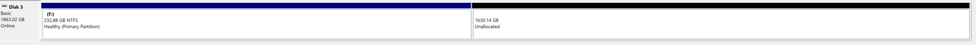

OK. I just had a look at the disk management and I can see this. How do I access the unallocated part, and why is there a partition? I never created one. Is this where the data I previously had stored is, and can I access it?
Thanks again!

You've formatted the f: partition, so that will have wiped that section
You'd have to use a data recovery tool if you wanted to get any data off that, there's a chance it will be lost.
The unallocated part I'm guessing was a different partition type, perhaps created on an older windows? But it looks unreadable by windows. You could try some kind of tool like TestDisk, may be able to read what's on there

Thank you. It is the unallocated part that I am interested in. There were never any partitions on the disk. This was inside a Seagate expansion external HDD enclosure that developed a fault (please see first post). The unallocated space here could correspond to the disk space that actually had the data, the 232GB sounds about right on the amount of free space the disk had before I took it off the Seagate enclosure.
If the disk had developed an issue, it's possible the sectors had failed which is a hardware issue on the physical disk, once the sectors are bad, they're lost and unrecoverable.
You can verify this by doing a chkdsk /r once you've got the drive readable in windows, if it returns any bad sectors, you know the disk is dying, it will fail sector by sector, could take 2 hours, could take several months.
I'm not suggesting to use EaseUS (although it is a very good tool, if you find yourself doing a lot of things with system partitions, it's worth paying for, for non-system partitions, the free version should cover you), if you carry on it gives you how to run the command in cmd.
But don't create any new partition on that area or format it as that will wipe anything that's on there, until you're sure it's unrecoverable, or you've rescued what you need.

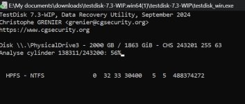

Thank you. At the moment I am using the test disk program you suggested. It could see thr disk as 2000GB, so the whole 2TB. How can I get the drive readable in windows? Another thought I have was to use the 'expand' functionality on disk management. Thanks again and apologies for the many questions

When I said I could use the 'expand' option, I meant to do so on the partition windows can see, so to expand to what it sees as 'unallocated'. Would that work?
That will overwrote the unallocated space with blank partition.
You need to restore that partition to be readable in windows, if you can’t then use TestDisk to recover what you can. The TestDisk site has guides
You may find EaseUS Free easier, it’s surprisingly powerful. I used it just a few weeks ago as I had a really old HDD from years ago which had been setup as a dynamic volume which was deprecated years ago. Dynamic volumes aren’t readable in Linux so wanted to convert it to standard. The normal way to do this would be to copy off the data and reformat it as a new partition, but I didn’t have space to copy off the data. EaseUS was able to change the partition while retaining data on the free version which is a pretty advanced process. I was really impressed
Thank you. Yes, ideally I would like to see if any of the data can be read. Then I just want to unify the drive in one, unpartitioned space.

I could not get the information I needed from the testDisk site so I just used the 'expand' option in the disk manager and at least got the disk to diplay its full capacity in Windows. I just need to copy the files in it again. Thanks for your help!

Do do a full chkdsk as already advised, if there are bad sectors you've got limited time until the drive fails fully.

I'd be guessing that the 232GB contained Seagate software/tools and that before you had problems was probably a hidden partition which you wouldn't have seen unless you went into disc manager
