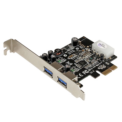

I’ve ordered a simple PCIe card with a couple of USB ports, if you use one of those as the power source for the screen it’ll turn off when you turn off the PC.
EDIT - I didn’t see that @SpyderTracks had written essentially the same thing above until after I’d posted!
mossmotorsport
I have a Corsair Commander Pro which I had forgotten was installed, which has two headers on. I wonder if this would achieve the same thing?
You're on to something there, from a brief look it does appear that they are standard USB 2.0 headers and should do what you're asking

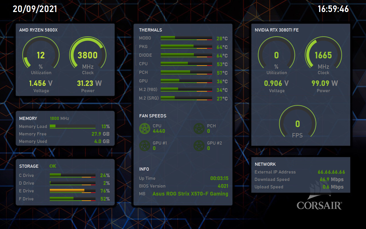

Seeing that I can't monitor all the fan speeds, I've changed the ones i can monitor to vertical bars
Just got to remove the PSU monitoring items now - even if you splurged on a HXi or AXi PSU you'd probably not be able to monitor them anyway ;)
Can you change the colour scale on the pump speed, as the amber seems to suggest the start of an issue...when we know it's perfectly fine for the pump to sit at that speed indefinitely.
I've got my 90/270º USB/HDMI cables to try now - just got to work out where to put the thing. Can't put it in the case - even though it fits well on top of the PSU with its little stand - as I won't be able to see it, so it's either under the monitor or on top of the RAID...or maybe stuck to the front of the case with some stand-offs so that doesn't block airflow?
That's looking good, ye as you say need to remove PSU monitoring items, and yeah i can change the colour on the pump speed, I just copied the mobo temp bar, changed it to vertical and swapped the sensors over then just chucked some figures in for speeds, I suppose really on the pump it should be red if its running at slow speed, any suggestions appreciated

For anyone interested, using a usb header on the commander pro now means the monitor does indeed power off with system off, without having to play around with bios power settings (useful for charging peripherals in an off state).

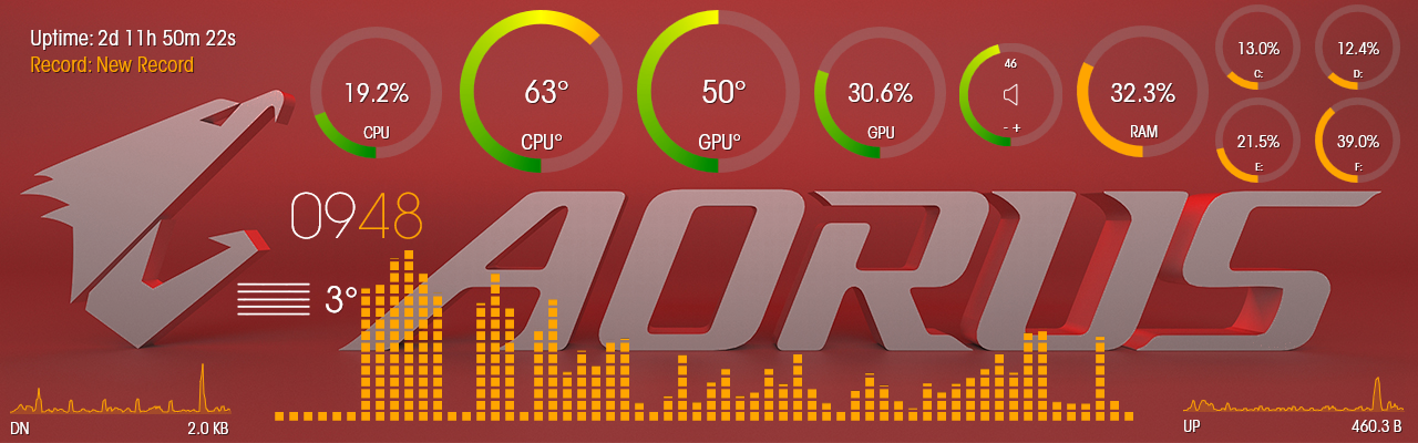

I've done something very similar (external only at the moment as I'm waiting for a PCIE bracket with big holes in to run cables out of the back of the case, but in my case I used Rainmeter.
Life is too short to be spent twiddling endlessly with AIDA64
My RGB colour scheme is evil red.
So I picked an appropriate wallpaper for my build and arranged the elements around it (I managed to use all but one element in one skin (after getting the dev to tweak a few things)
Screenshot of screen shows this:
It does look rather more vibrant in the flesh, and I have an even brighter variant for when it's behind the rather heavily tinted side panel of the 4000D, although this is good as wires and the like are mostly invisible with RGB & light up elements showing clearly.

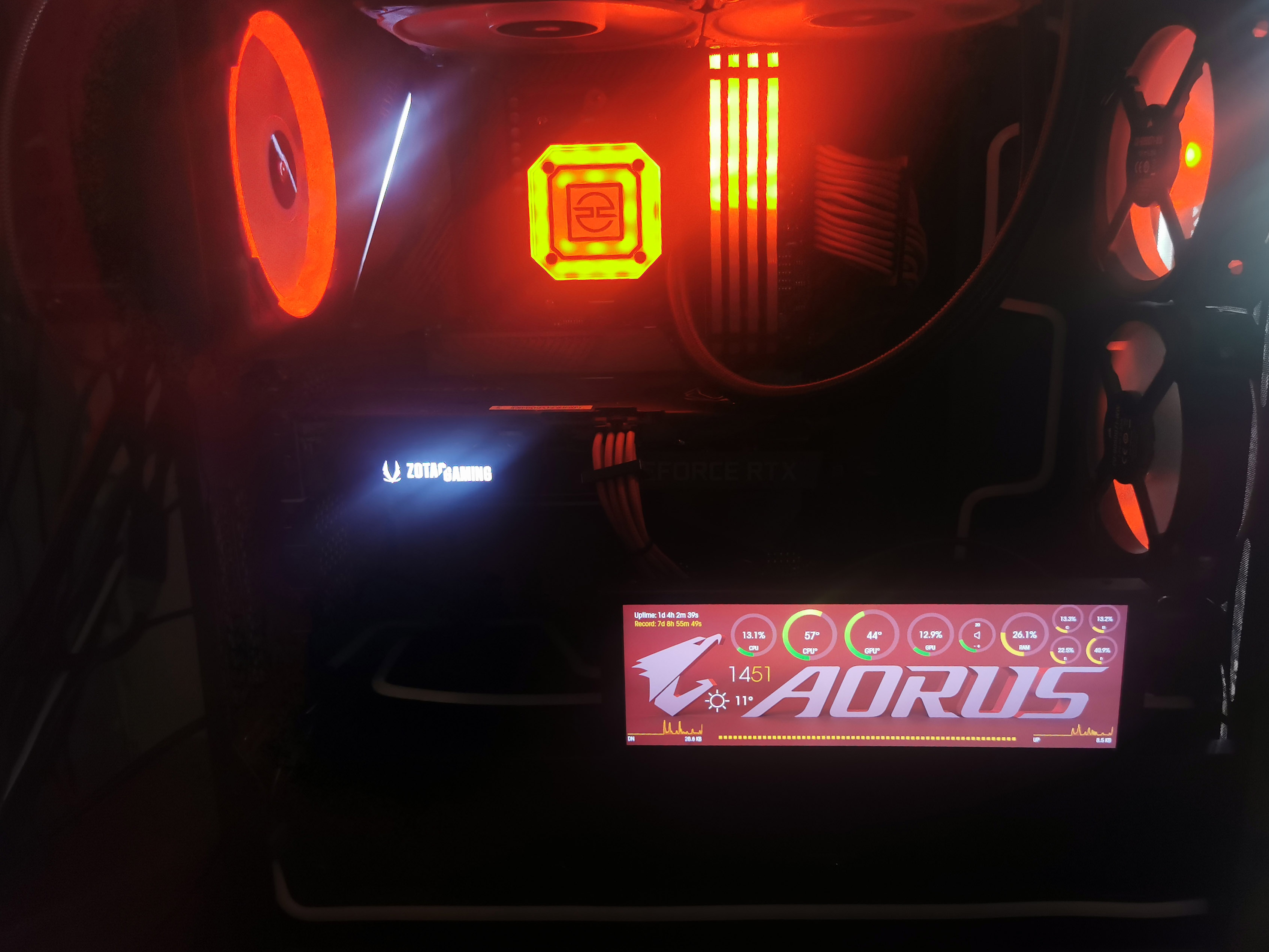

Once the bracket comes I'll mount the screen inside using magnetic tape (the display is fully boxed) the PSU shroud is metal and runs full length along the case. Then I'll run the HDMI & Micro USB along the motherboard side of the case and out through the big hole PCIE bracket to the ports on the back of the PC, my case (Corsair 4000D Airflow) has absolutely nowhere I can route apart from that.
techguyone
After a bit of a false start (I somehow manged to order a small PCIE Bracket) so it wasn't long enough...
My silver full length PCIE Bracket cover came, so once I'd sprayed it matt black I was able to proceed...
I ran the HDMI & Micro USB along the motherboard side of the case and out through the big hole PCIE bracket to the ports on the back of the PC
View inside case and behind glass. The magnetic tape meant I could position it really well and the HDMI/Micro USB connectors are all running 90 degree adaptors. Thankfully the rather heavily dark tint of the window hides a lot of wiring stuff, although I made everything black and routed it fairly discreetly. You only see what you want to :)
The white tubes are airgoo neon strips which light up red and chase around all 4 of them. I took the picture with them early in the cycle so you were not distracted by bright glowy lines. I also ran an adaptor cable to a Corsair Lightning node pro on channel 1 which means that now if it's lit up, it is controlled via Corsair, plus I have a spare channel free if I need to do anything further down the line.
Overall I'm quite pleased, it's come a long way from being almost completely dark inside and on the front to this
