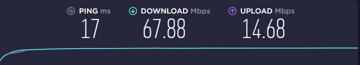

This is a re-test of my PC being connected with Ethernet

So that clearly shows an issue with the wireless. It could be distance related. How do other devices perform on wifi in your room?
Now that's more like it. As has been said there seems to be a wireless issue. Go to the wireless card vendors website and download the right driver for your card and OS.
Then uninstall the wireless card and reboot. Then install the downloaded driver. If that doesn't help I would suspect a faulty wireless card.
