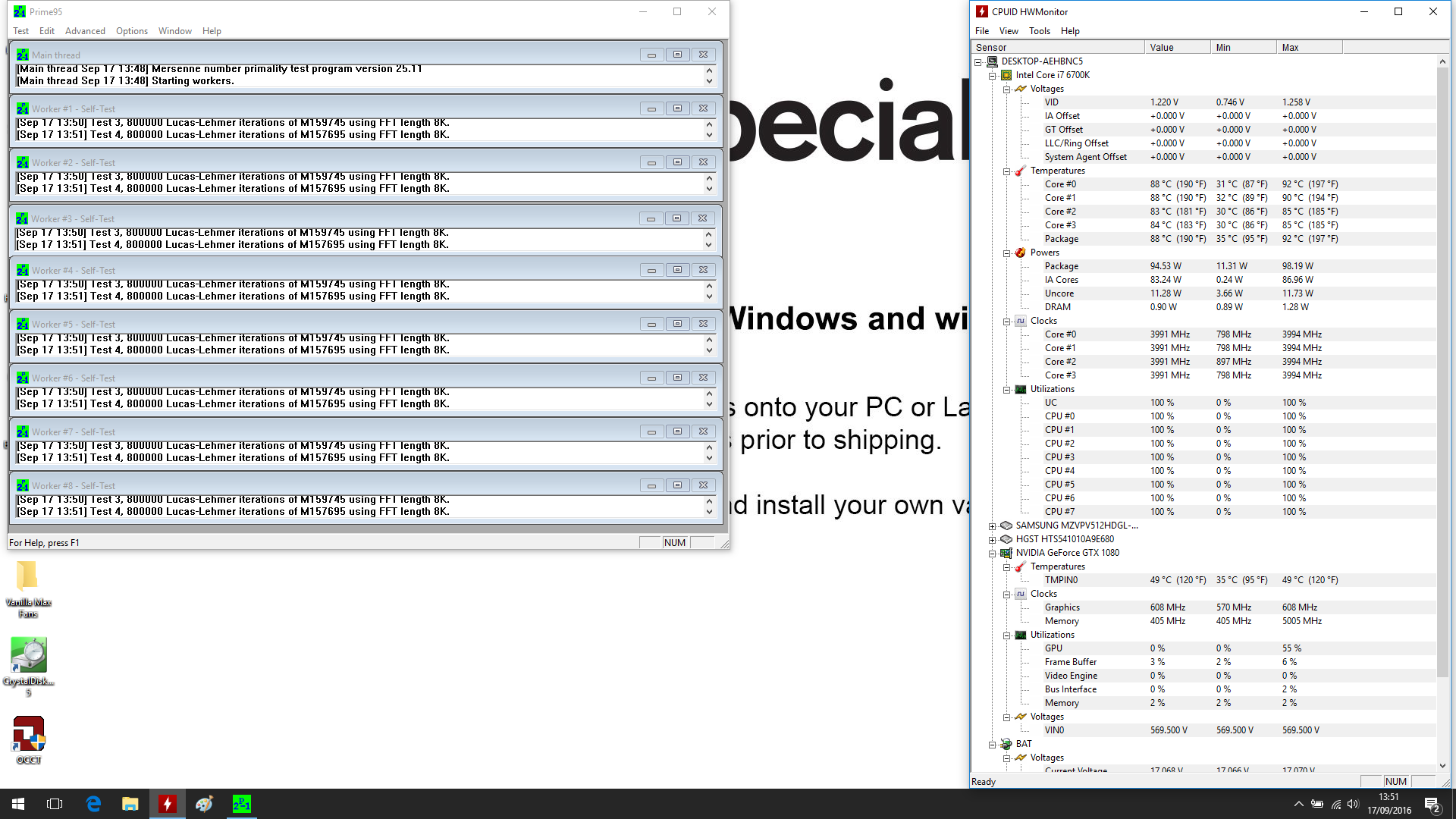

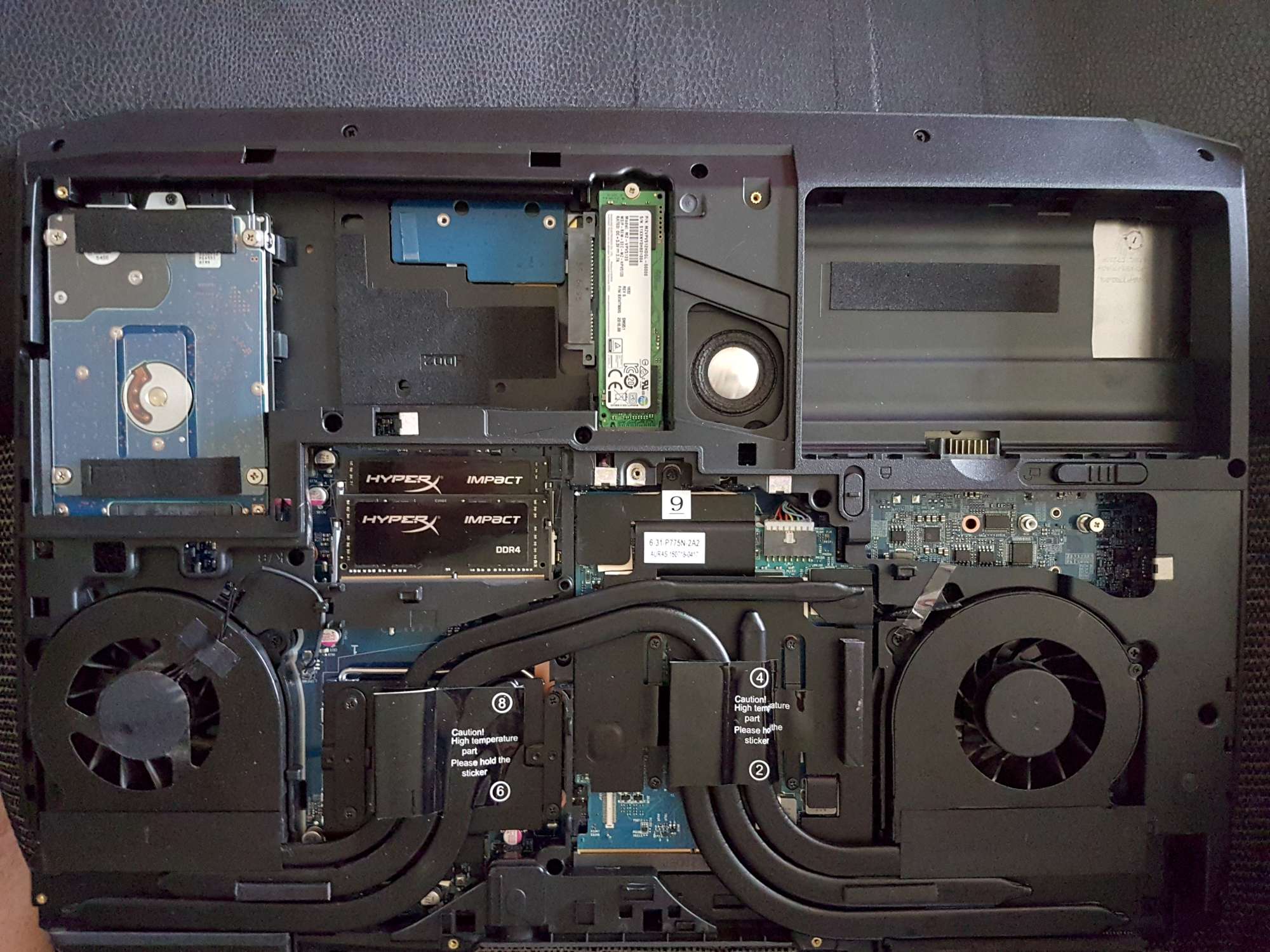

So I ran a couple of VERY quick benches and found it overheating like mad. At first I thought it was the poor pasting job as it looked like it had been slapped on with a trowel. Some new paste (AS5) later and there was an improvement, but it was only 4 or 5 degrees.... not what I was after. Strangely I didn't receive the used tube of MX-4 so I'm wondering if it wasn't used in my build, even though I paid for it.
View attachment 8794View attachment 8798View attachment 8797View attachment 8799
AS5 in its place.
As I said, I only got a few degrees from doing the above so I decided to check out the fan profiles. The control panel as installed stock is incredibly buggy, everything needs to be installed in the correct order or there are conflict issues that stops both the OC panel from working and XTU from installing correctly. I wiped the OS a few times though while playing so I got around all of that eventually. The Fan profiles works right off the bat though so I selected "Overclock" and everything ran great from then on. Very cool![]()
