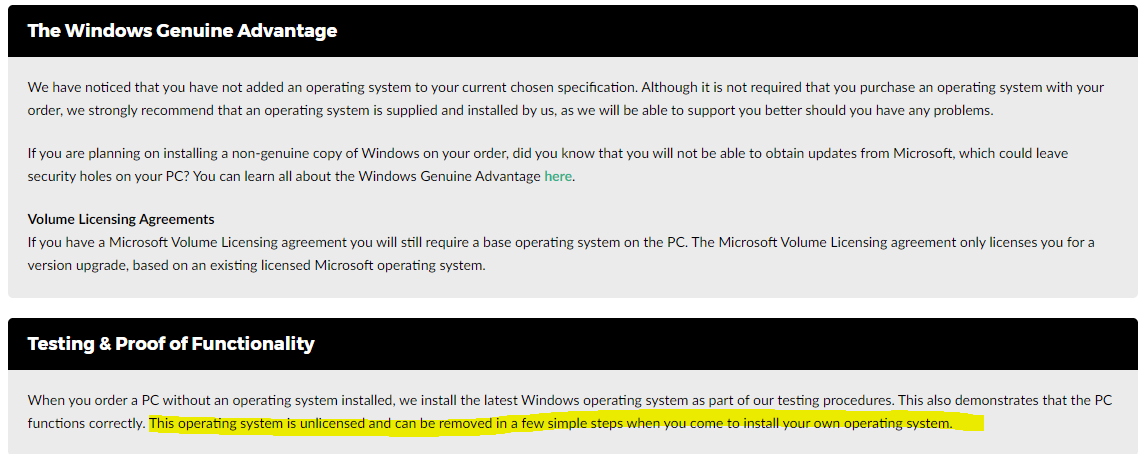

PCS give the heads up in the check out process:

@purplewakanda needs to confirm what she has ordered first before she reinstalls uncecessarily.
FWIW - I ordered without an OS and upon first boot I was met with a desktop bakground that clearly indicated the Windows install was for testing purposes only. If the OP didn't have that screen - and ordered Window 10 Pro with her build - then I expect all is well......
