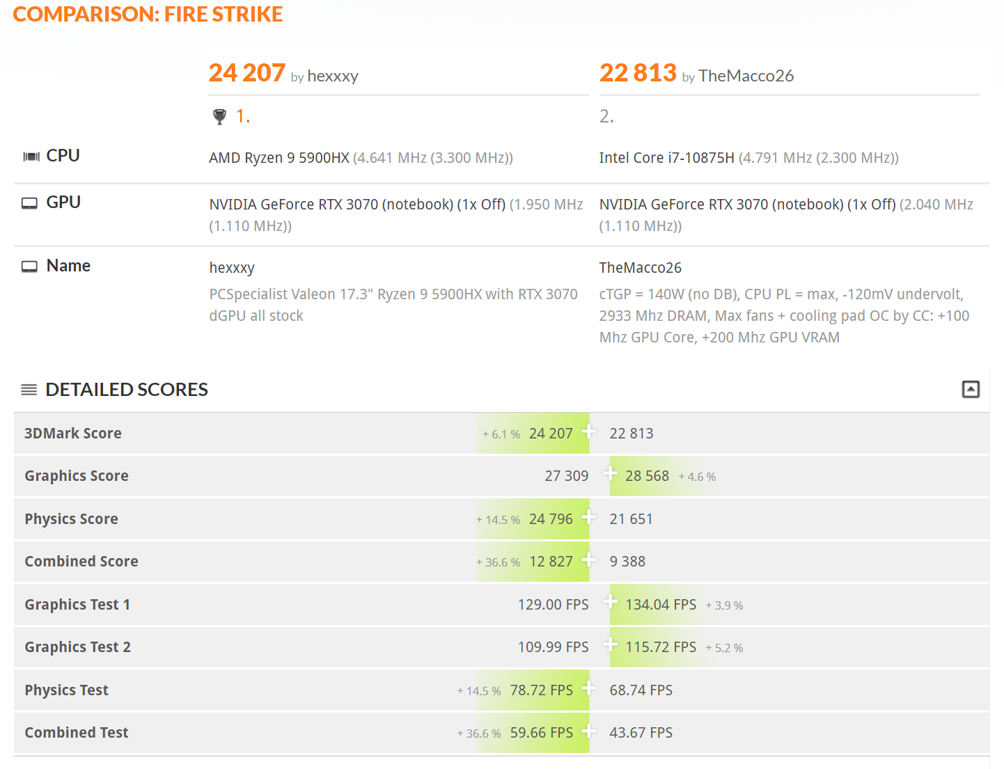

Since everybody is putting OC results, let's put something for the Intel 10875H+RTX3070 variant of the Ionico.
Settings (all by the Control Center minus underVolt by Throttlestop):
cTGP = 140W (no DB), CPU PL = max, -120mV undervolt, 2933Mhz DRAM, Max fans + cooling pad
OC by CC: +100 Mhz GPU Core, +200 Mhz GPU VRAM
PS: I know this thread is not sorting results for Timespy, but should you be interested, here is the LINK (10884, 11175 Graphics) for same config.

Just ran at test on my new stock Valeon 17.3" laptop as below , using dGPU only , not MShybrid .
Fairly good scores from it :)

That CPU is a beast, but you can push your GPU a bit more with the CC, you should use the latest and greatest April revision from PCS.
KriSta
It can probably be mitigated also by using faster memory . I opted for 2666 Mhz DIMMs as they were in stock at time of order . I know that the Zen3 works best with 3200 Mhz DIMMs so that is on the to-do list to get .
Macco26
Expert
I assume you can't turn off the MEM OVERCLOCK page in the BIOS via the Control Center, in the Profile section, last command after GPU and fan inertia, right? I assume you can't as the memory controller for AMD is inside the CPU and not something you can fiddle in the motherboard with..
KriSta
Correct , I seem to have no means of changing the memory speed in the Control Center or in the actual BIOS . What I see is what I get , no means of tuning it separate from CPU .
