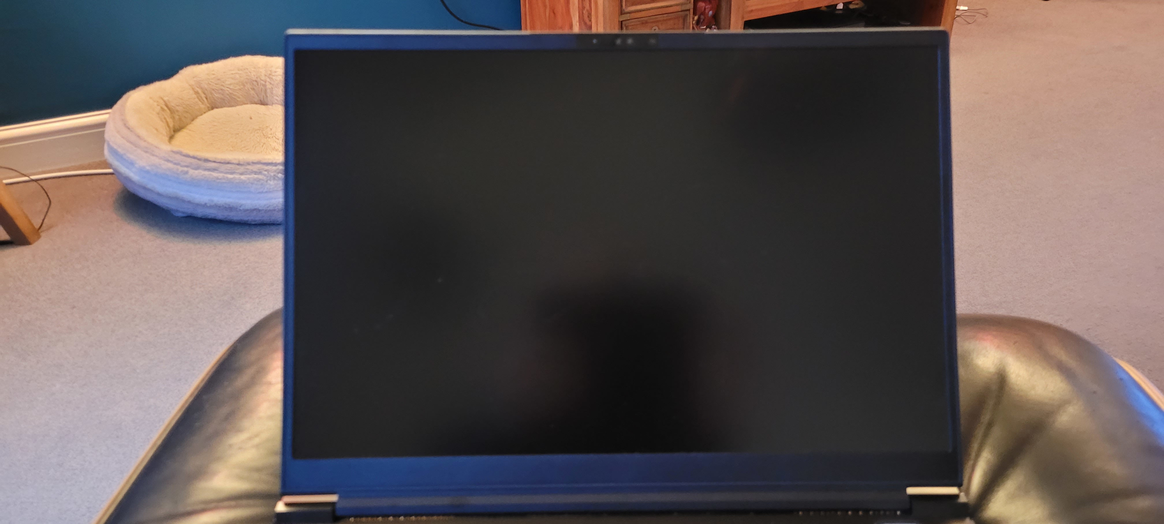

The machine has a variable refresh rate, 2560 x 1600px panel that has a stated 100% sRGB coverage (I will test the panel and post the results later)
LCD panels will always have some backlight bleedthrough -its not a bug, its a feature...but seriously, the technology of blocking light with crossed polarisers will never approach the inky-blacks of OLED technology but, I can say that the 1600p 240Hz panel on the 16" Ionico is among the best example of the technology that I've seen. I created a black BMP file and viewed it with the panel brightness at 100% (see below) note-this is just a quick and dirty view with plenty of ambient light -to the eye, the panel is black (the irregular splotches are reflections off the rear wall.)
I could repeat this experiment in a totally dark room (with a camera that has a better dynamic range) and I'd predict that under those conditions we might be able to observe some light leakage around the points where the panel was under some stress (usually around the hinges) but, if present this would be negligible and invisible under normal viewing conditions

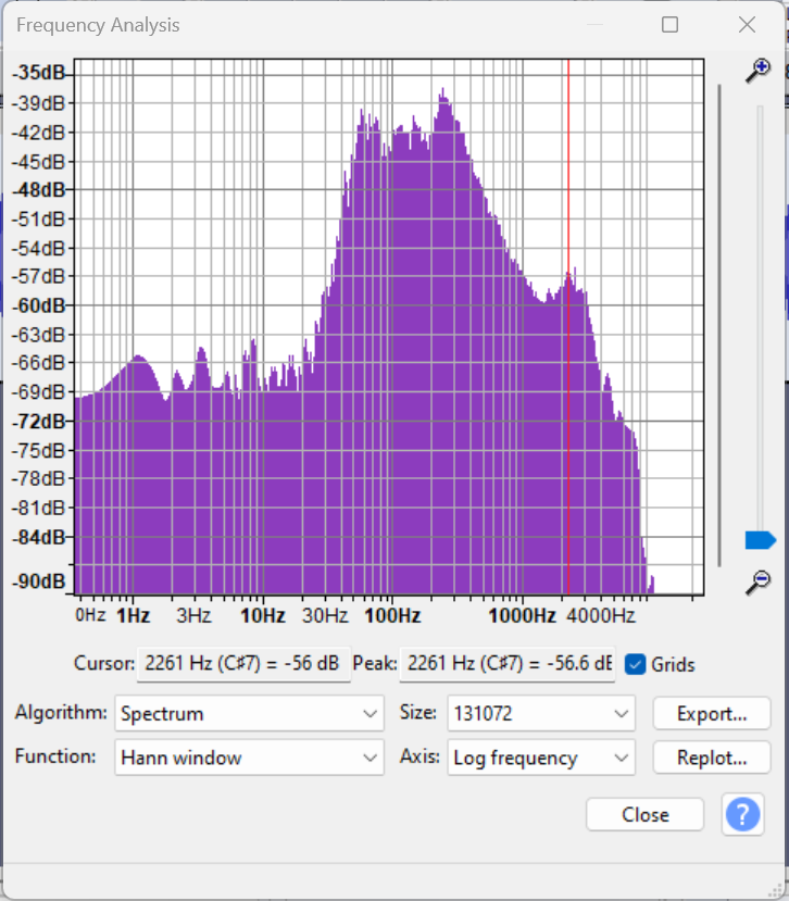

The cooling system is audible at idle and the noise generated by the fans has a noticeable high-frequency whistle located around 2KHz (see below), I don’t find this intrusive but this is very much a personal preference and at idle, the CPU runs at about 35 degrees above ambient.
