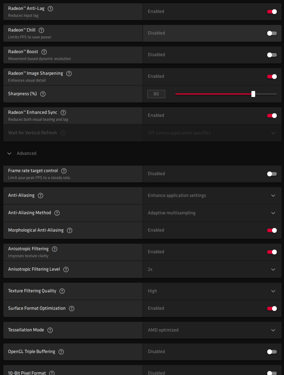

Oh no, someone is in trouble now?@SpyderTracks @Martinr36 @Citrus_9 I switched off AMD Freesync and the sleep issue seems to have stopped. What's the point in getting this monitor if I have to switch off Freesync so that sleep works!
You mean turn on Sync in AMD settings and not the monitor?Oh no, someone is in trouble now?Could you check AMD settings?
I'm under impression that your PC is with a 6700XT GPU (?) - check AMD graphics settings. I'm just guessing here as I don't know what are the AMD graphics settings - will know soon thoughYou mean turn on Sync in AMD settings and not the monitor?
Yes, it is. I've turned on sync. Is there anything else I need to enable?I'm under impression that your PC is with a 6700XT GPU (?) - check AMD graphics settings. I'm just guessing here as I don't know what are the AMD graphics settings - will know soon though![]()
