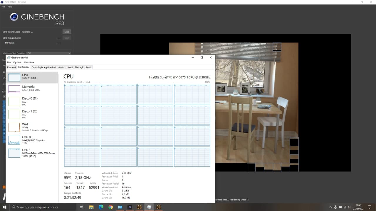

Guys, something is really strange here, my unit seems to not have anymore the problem. I was cleaning inside from dust having the laptop since the last july, i detacched some cables (battery and other cables near) to be safe, and then started again. I was lolled when tested if everything was alright as before cinebench in battery mode stayed at steady 2ghz, without any drop to 800mhz like it used to be. But can be even some windows updates maybe? Trust me guys, i don't know but seems to be actually fixed here. I have to test more if the laptop still perform like that even when battery is low (i was on 100% and i test till it was around 60% if i am not wrong).
I not proceeded to contact pcs to have refund because is my main pc for work, study and hobby, and i can't loose 2 months for be back, and actually the problem does not bother me too much cause i was using only for office and conference on battery, but now seems to be een fixed, i only don't know if is some windows updates or if detacching cables inside and reattaching fixed in some way the issue.
Only thing i know is that i am pretty happy about this unexpected thing.
GiuFam
Here's the proof of what i am saying, test with cinebench and heaven benchmark opened in background:

See what happens when the battery drops below 25% I would put money on the fault happening.
You are right man! At the beggining I had this problem also at full battery, toghether with an annoying keyboard stop working that have forced me to reboot many times, but after BIOS upgrade I didn't notice the drop in performance anymore and the keyboard issue only happen rarely. But now I tested under 30% battery and the fault is there. The problem is that I bought my Vyper in June 2020. Do you think that this fault with low level battery it would be enough to request a refund also after so long?

yes i did a couple of test this week and as you stated when battery go below 50-60% it starts to show the usual drops, even if not as severe as before. The more battery is low, more is pronunced this effect. The good thing is that is not as severe as it was before (i have very long drops and frequent, now at 50% are more infrequent than before on 100%), and for office use it work fine (youtube, word suite, chrome). Is a shame to can't use this laptop in high performance mode when on battery but i cannot stay 2 months without a working machine unfotunately, not having a decent backup pc to use in that time (i only have a i3 4004y dell venue pro 11 as backup machine, and basically i can't do nothing of work on it).
