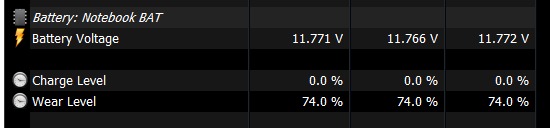

I've had my Octave V for almost 3 years now (it will be in December) and today I just noticed that my battery wasn't charging anymore when plugged in to the wall (the icon in the windows tray doesn't move, it just says plugged in but it receives no juice whatsoever).
Checking the wear level on HWinfo tells me that it's at 75% which is super strange because it was at 40% not too long ago..
Now when I unplug the AC adapter from the laptop it shuts down immediatly, I've never had this happen before so I'm not sure what happened here.
Should I go ahead and buy a new battery on PCS since the option is available ? (yet quite pricey)
P.S : My laptop is always plugged in to the wall, maybe that's the reason why the battery died so quickly ?
Yes, that one certainly looks like it's had it.
There's nothing wrong with having it plugged in all the time, but make sure you turn off the plug at the wall when it's not in use, otherwise that will constantly trickle charge and degrade the battery when you're not using it.

Batteries are only covered for the first couple of months mate due to their volatility and ease of user damage, worth asking though
You wont get a battery under warranty, they are only covered for 6 months:
7.7Laptop Batteries come with a maximum 6 month warranty, regardless of which warranty option is purchased.

Received the battery, works as intended so I'm pretty happy with that.
