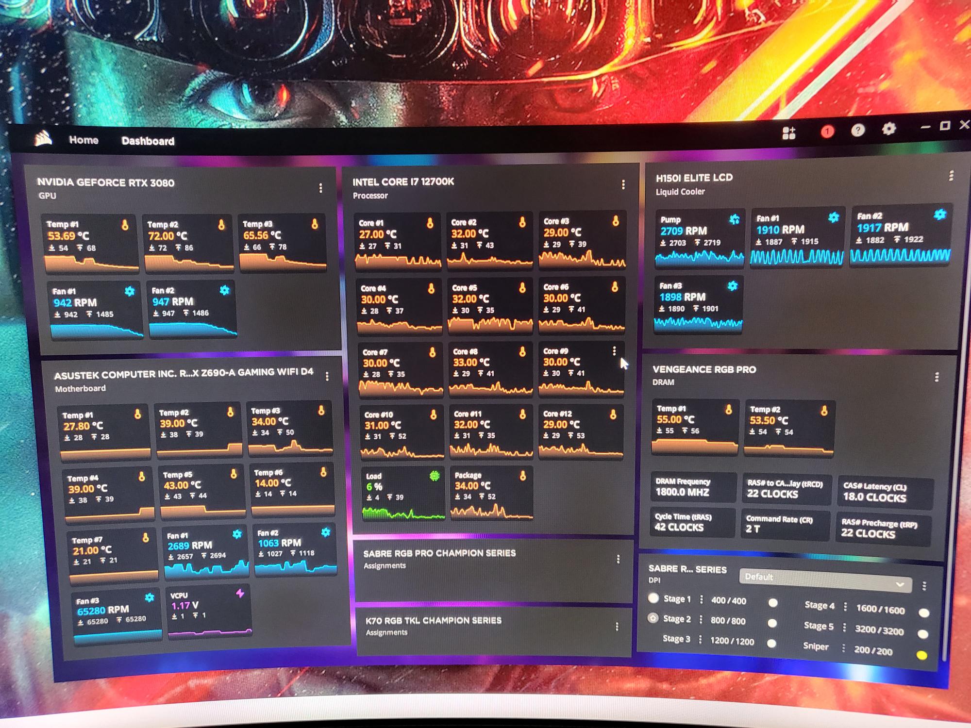

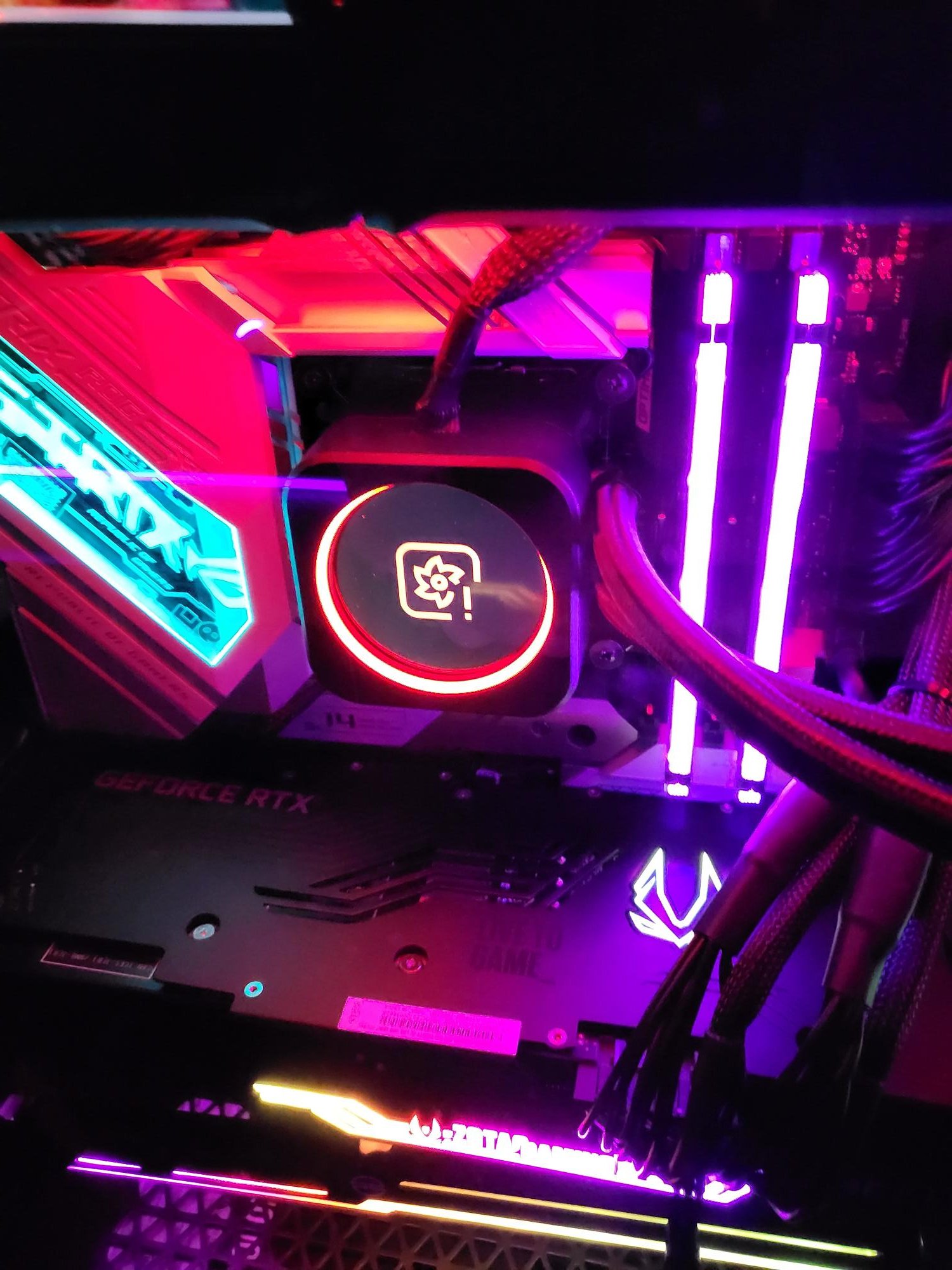

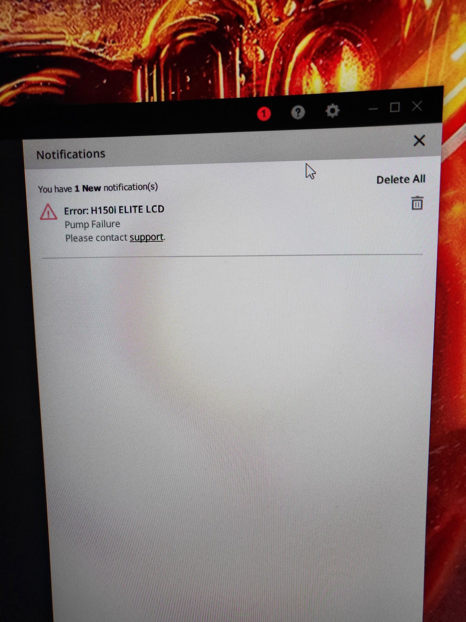

All was well until tonight I got this screen with a pump failure alert. I had been playing warzone for about 15 mins. Fans were set to balanced mode in the icue software.Hopefully it remains working fine. Definitely check if there are any software or firmware updates for the cooler and iCUE.
I would definitely get it replaced personally, it's not the sort of thing you want to risk being dodgy at the expense of the CPU and / or motherboard, possibly PSU also. Not worth risking it, I'd get it swapped out.All was well until tonight I got this screen with a pump failure alert. I had been playing warzone for about 15 mins. Fans were set to balanced mode in the icue software.
I switched the pc off and booted it back up again. I started icue and it's was showing normal on the lcd screen but I did briefly see it was showing a cpu temp of minus 50 for a few seconds. The alert then came back on again with the cooler fans running at full speed.
I switched the pc off for 5 mins and restarted it again. The message is gone and everthing seems back to normal.
Was it perhaps just a glitch or is it on its way out and needs rma?
Any thoughts would be appreciated 🙂
Yes latest icue software which was released a day or so ago and everything connected showing no updates available.I would definitely get it replaced personally, it's not the sort of thing you want to risk being dodgy at the expense of the CPU and / or motherboard, possibly PSU also. Not worth risking it, I'd get it swapped out.
It's definitely on the latest firmware?
Think that's a wise move, it's definitely not right, these new cooler have bugs but not like that, that's something more serious.It seems there is definitely something up with the aio cooler. I have just filled in the rma form on the website and waiting for it to be approved.
