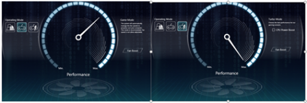

Game / Turbo modes:
The system will automatically adjust your fans as it sees it needs to. You can not adjust this mode - its an automatic mode that base don the temperatures of your CPU and GPU, the fans will kick in and get louder or when cooler, slow down and be quieter.
There is a Fan Boost mode to this - which basically sticks the fans on full blast by the sounds of it - not sure if there is a fast-key way of putting boost mode on.
Turbo mode increases the performance of the fans and speed higher than normal gaming mode - so if you play some intensive games where the temperatures do get hot quickly and you can bear a bit, ok a lot, more noise from the fans, then you may be better having it in this mode to help with the cooling.
There is also a CPU Power Boost to toggle on / off for Turbo mode.
