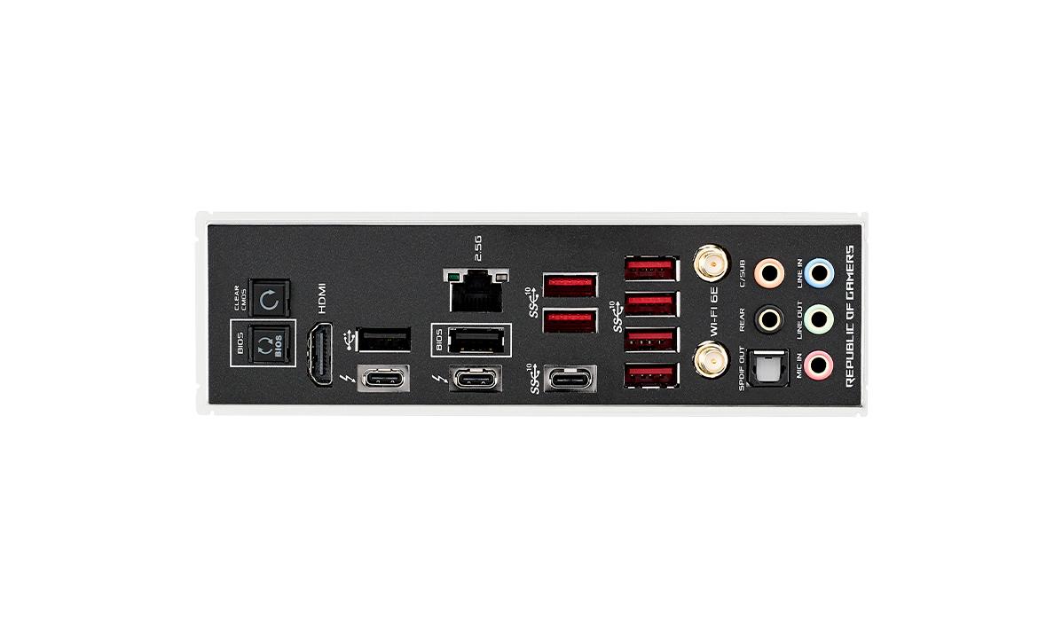

Thank you. I thought Thunderbolt was just for Macs. However when scanning through the different motherboards in the configurator I dont see it mentioned in any of the detailed specs but a few of them have it in the description eg: "Thunderbolt™ (USB4®) header support" How do I tell for sure how many Thunderbolt ports a motherboard has? Thanks again :)
The specs should tell/show you what ports a motherboard has...but if it doesn't have any but has a Thunderbolt header, you can add a card in the specs to give you a couple (or couple more) TB ports.
The picture for the Z690 Maximus below shows 2 Thunderbolt ports (with the little lightning symbol on them):
...and the description says:
USB Ports
Rear USB: 2 x Thunderbolt™ 4 port(s), 7 x USB 3.2 Gen 2 port(s), 2 x USB 2.0 port(s) Front USB: 1 x USB 3.2 Gen 2x2 connector(s) (suppport(s) USB Type-C®), 2 x USB 3.2 Gen 1 header(s) support(s) additional 4 USB 3.2 Gen 1 ports, 2 x USB 2.0 header(s) support(s) additional 4 USB 2.0 ports​
