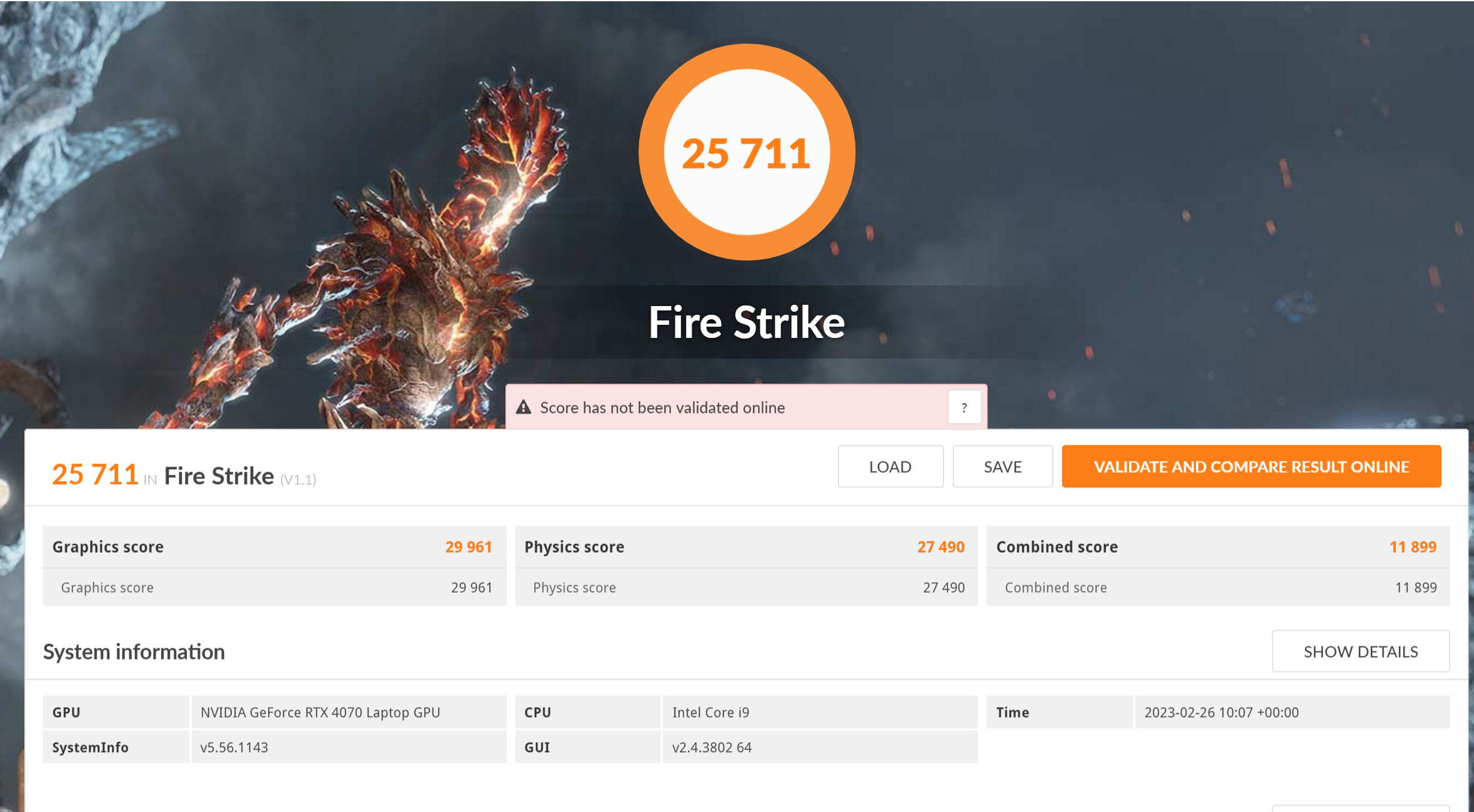

The 3Dmark score for firestrike is >25K (and could probably be pushed even higher with some GPU undervolting)

With regard to the CPU performance, this is in line with the well-documented results published for this iteration and this processor can keep the GPU well-supplied with draw calls (which is all most people will care about) and should be more than capable of running most conceivable CPU workloads.
