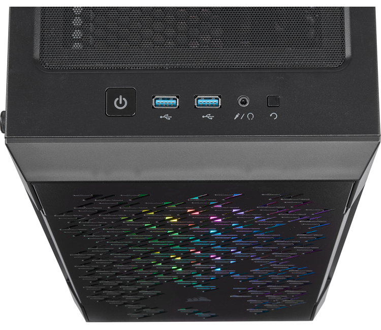

With the new dimensions in mind, the original one I suggested should be perfect (the Corsair iCUE 220T)...
OPTION 1 (with Windows)
CORSAIR iCUE 220T RGB AIRFLOW MID TOWER GAMING CASE​
AMD Ryzen 5 5600 Six Core CPU (3.5GHz-4.4GHz/35MB CACHE/AM4)​
ASUS® PRIME B550-PLUS (DDR4, USB 3.2, 6Gb/s) - ARGB Ready!​
16GB Corsair VENGEANCE DDR4 3200MHz (2 x 8GB)​
8GB AMD RADEON™ RX 6600 - HDMI, DP - DX® 12​
1TB INTEL® 670p M.2 NVMe PCIe SSD (up to 3500MB/sR | 2500MB/sW)​
CORSAIR 650W TXm SERIES™ SEMI-MODULAR 80 PLUS® GOLD, ULTRA QUIET​
1 x 1.5 Metre UK Power Cable (Kettle Lead)​
STANDARD AMD CPU COOLER​
STANDARD THERMAL PASTE FOR SUFFICIENT COOLING​
ONBOARD 6 CHANNEL (5.1) HIGH DEF AUDIO (AS STANDARD)​
10/100/1000 GIGABIT LAN PORT​
Wireless Network Card
WIRELESS INTEL® Wi-Fi 6 AX200 2,400Mbps/5GHz, 300Mbps/2.4GHz PCI-E CARD + BT 5.0​
MIN. 2 x USB 3.0 & 2 x USB 2.0 PORTS @ BACK PANEL + MIN. 2 FRONT PORTS​
Windows 11 Home 64 Bit - inc. Single Licence [KK3-00027]​
United Kingdom - English Language​

Corsair iCUE 220T case looks like this (if you have the unicorn vomit enabled)...
