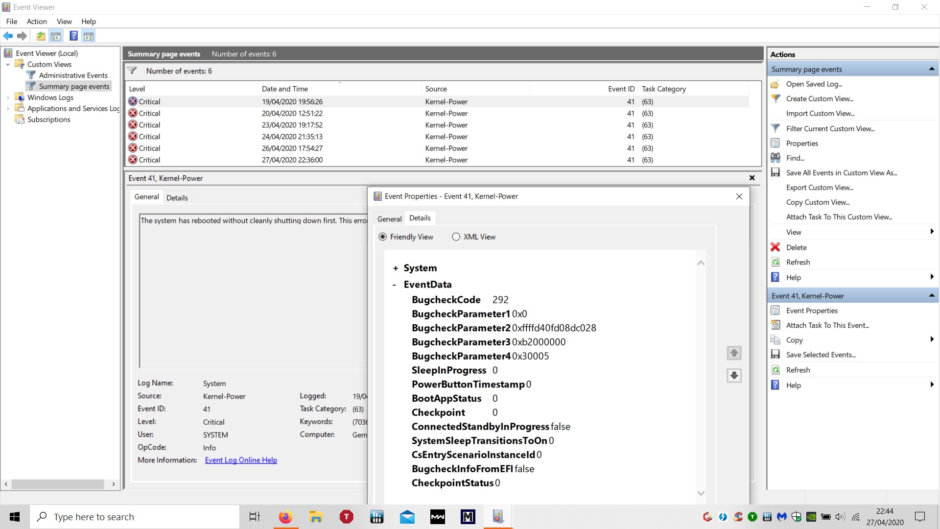

I have got few BSODs I must admit but only while playing anno 1800, WHEA_UNCORRECTABLE_ERROR , dont know if this is because of undervolt but never happen in another game, maybe @SpyderTracks will have a clue? actually happened 3 times in last week but never in another games tho.
I would expect it to be the undervolt. Am I right in thinking you're at -135mV? That's extremely high.
Different games will draw different loads. Anno 1800 is very CPU bound whereas most games will draw from the GPU.
The Kernel Power error is just a flag for when it's restarted incorrectly ie BSOD or power outage.

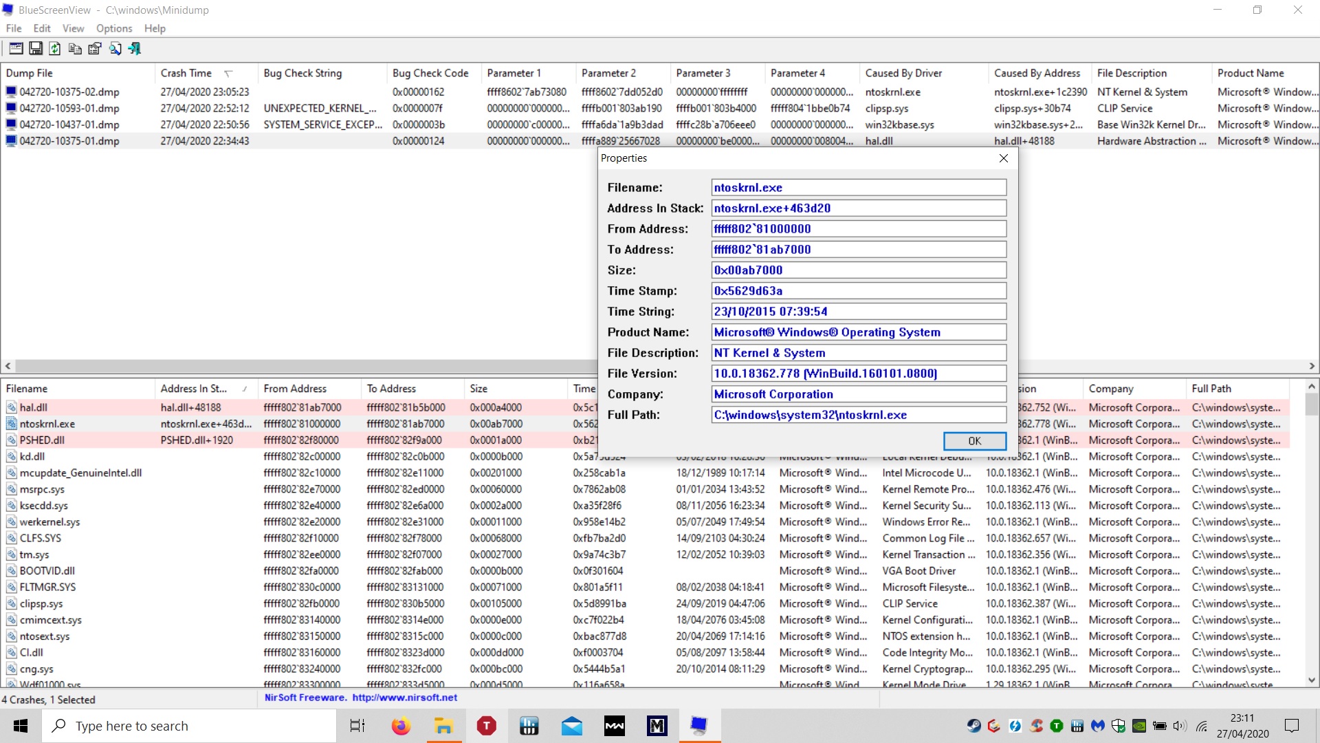

i had run prime95 but getting bsods even on stock with different errors hmm strange, im on actually -250mv on core and -110mv on cache, i have been stressed with aida64 couple of times but cannot get thru prime95 will post dump files tomorrow maybe some of you will have a clue, dont know if it isnt related to drivers by anychance. all of them has ntoskrnl file in it. i had a look maximum load while extreme gaming was 51,5W although prime test i seen up to 84W :O
Prime95 is a much better cpu test than aida64, it will actually throttle the full performance whereas Aida won’t.
Lemon_Haze
yep, i had ran it on stock but bsod after 20-30 seconds hmm... will see tomorrow again and i try post dump file what has been causing issue, but as i said i never had any problems only after longer anno gaming but that is cpu demanding but still, it didnt meant i was stable. will try to get prime work tmrw
Almost all driver related BSODs have ntoskrnl as the failing module. That's the main part of the Windows kernel. If a driver screws up it's almost always the kernel that detects the problem (when the driver returns control to the kernel) and since the kernel contains no driver specific error recovery routines all it can do is BSOD. Often the dump produced will indicate the failing driver (the kernel knows which module it was) but even that's not guaranteed.

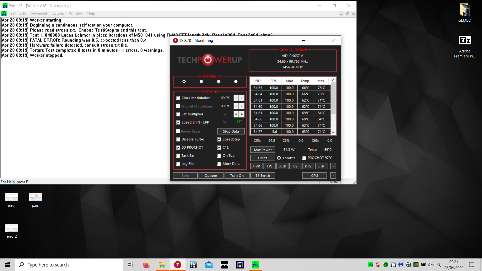

hi mate thx for reply, just ran prime95 again no bssod but this message came up
I have uploaded minidumps from yesterday maybe you will have a clue, my guess is drivers but I not sure after this messgae pops up
  • minidumps.zip
That’s the undervolt, there’s not enough power for the CPU requirements so it reads it as hardware failure:
yep u right i tried 110mv on both now still testing, seem as succesfull i think, thanks !!!
