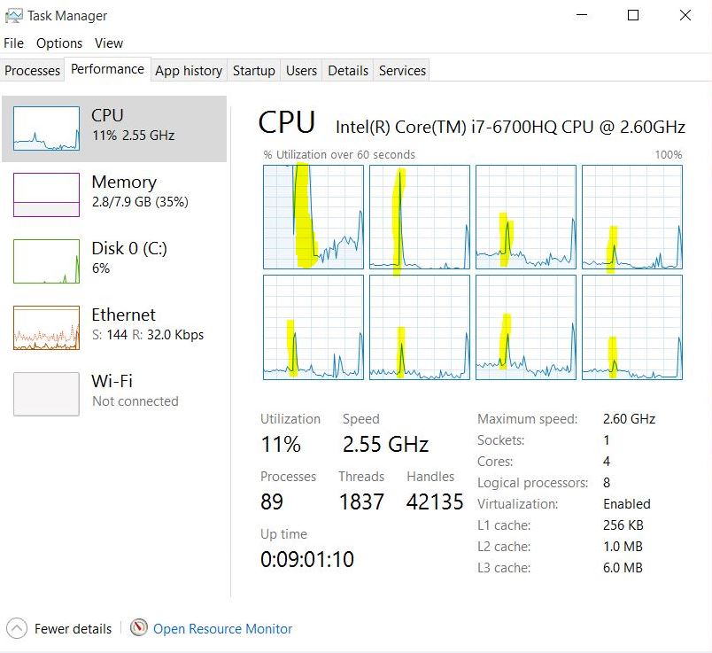

Hi,
I have the Optimus VII with Windows 10 pre-installed and have been having this problem since purchase.
My laptop basically randomly have lag spikes. The "spikes" lasts for about half a second. When it happens, sounds (any sound currently playing) will be distorted (paused, and then "dragged on" for half a second then after the spike is gone it "resumes" the sound), my cursor will not move and my desktop will temporary freezes.
I have left Task Manager opened but it doesn't show any CPU spikes when the lag spike happens.
There appears to be CPU spikes. Across the "logical cores" (hyperthreading included), Core 1 spikes the most then gradually going down with Core 8 being spiked the lowest.
This has been going on since I first turned it on out of the box. If anyone have any ideas, please help.
It is very annoying when playing games, watching movies, or....everything actually. It doesn't matter if I'm in a fullscreen game or windowed (same with videos).

Managed to get some CPU spikes this time.

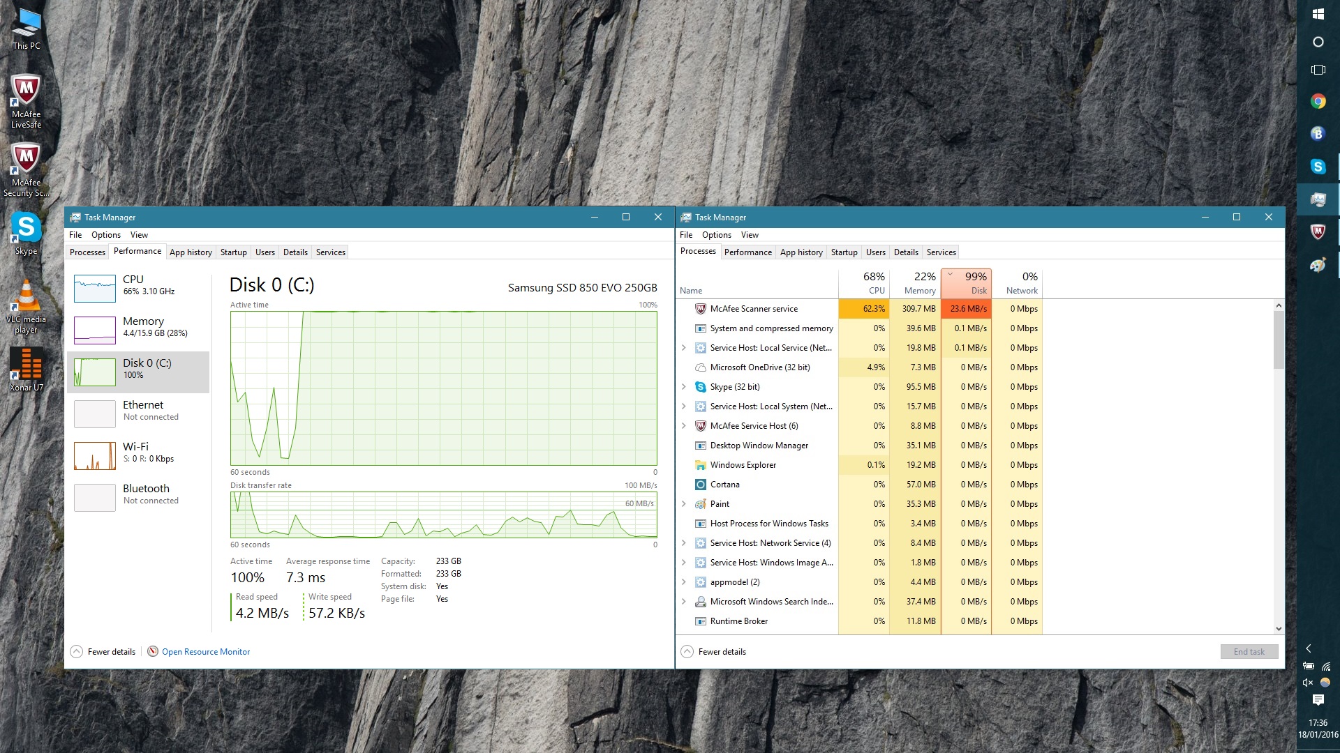

I've experienced some spikes today when mcafee started its scheduled scan View attachment 7752 We might be on the same boat.
Don't think so.
First, I have Kaspersky.
Second, yours is a long stutter. Mine is a short spike.
Lastly, yours lag because disk usage. Mine is CPU spike (the only thing I can think of as it shows in Task Manager, other than that I have no idea).
