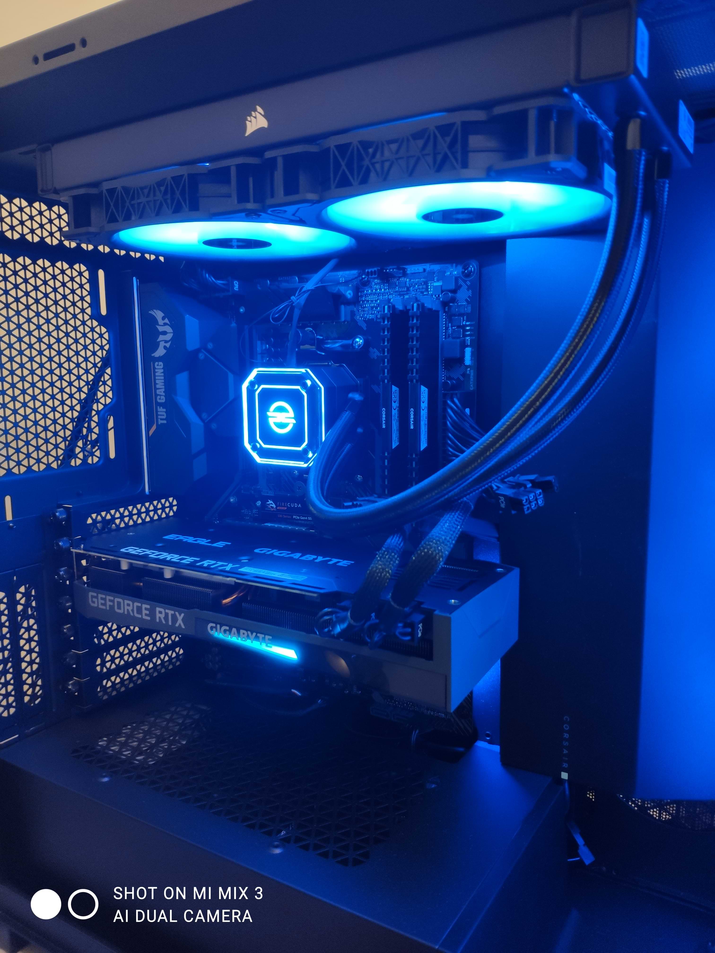

Can you take a pic of inside the PC? I think this is the opposite of what I was suggesting. Remember that air goes up :)

Here you go mate
There you go mate

Yeah, that's what I was thinking. you put the book under the wrong end.
However, I'm thinking (given the layout) that you should go extreme and put the case on its back. From the picture rotate the entire case 90 degrees counter clockwise. Sit it on a couple of books to lift it off the table and stop any weight from going on the cables. That will literally be as good as it gets for getting rid of air bubbles.
Silly me🤣Thanks, Scott. I'll try that once I have a spare moment and let you know how it goes.
