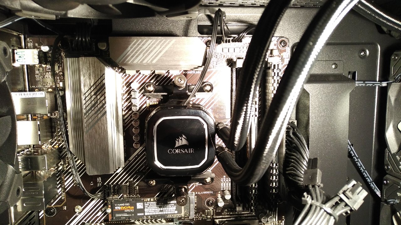

Photo of the pump from the front. The lights don't come on when PC is turned on as you say.

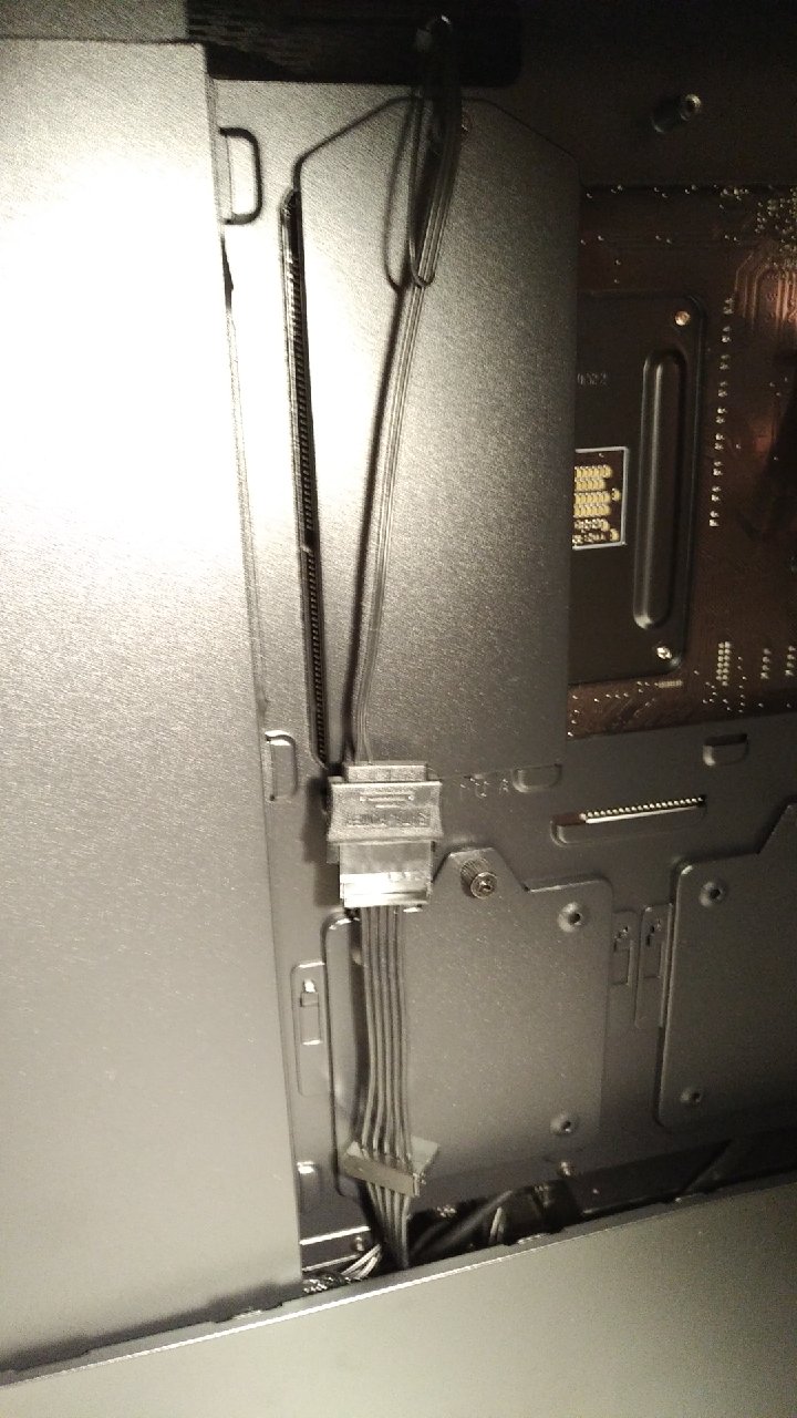

Second photo is from the back where the SATA power cable is routed. I traced it to the PSU and it seems to be connected to the PSU correctly.
Excellent photos, that's great, thanks.
So firstly, the fan header should be on the left three pins with the 4th blank.
That will probably remove the BIOS error.
I'm still concerned that the pump light isn't coming on. If possible (I'm not familiar with the case) can you unplug the SATA Power cable that it's plugged into at the PSU end and plug it firmly back in?
Apologies, apologies, scratch that, they've inverted the fan header, so it's upside down, it is in correctly.
It must be just the power connector then, I think we can leave the fan header.
Ganymede
Tried to unplug the SATA cable from the PSU but it's v difficult to access and I can't really unclip the locking clip. :-/
Ganymede
I connected the front LED lights to the same power cable line as the pump and they came on. Wondering if the pump is suddenly faulty since delivery... :(
Yeah, they're pretty tightly packed in on some cases.
Hmm, that does suggest the pump is faulty, I would give PCS a call.
They should be able to just post out a replacement H100x rather than you having to send the whole build back if you're happy fitting it.
It would be delivered by DPD next day and the courier would take the failed unit off you and return it to PCS.
