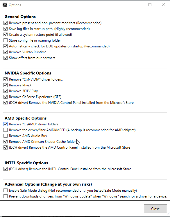

Had a look at DDU but there were loads of options and enough warnings about knowing exactly what you're doing that I didn't feel comfortable running it. I don't want my new PC to become unusable because I didn't choose the right options.
I reinstalled the driver using NVIDIA GeForce Experience, but Device Manager is still reporting the older version. Maybe I need to bite the bullet and run DDU anyway. What settings should I use for it? Do I need to do a backup of some kind before running it?
The only thing you need to do is check all the boxes for nvidia including PhysX which will be unticked by default, then leave the rest as they are:
Then in the main program window, in the right hand side "select device type" select graphics, then underneath, select the nvidia card, then click "Clean and Restart" in the top left:
It may flash up a warning about being in safe mode at the start, personally, I've never used it in safe mode and never had an issue.
