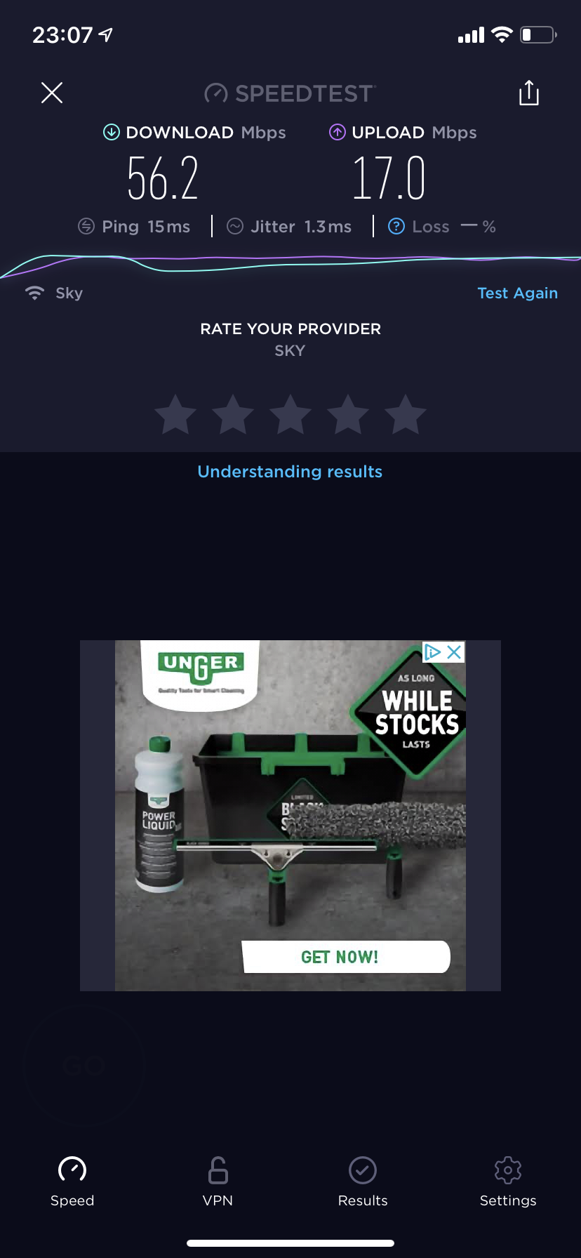

Here’s the spec. I’m using the speedtest by ookla.
I get 60 megabytes of download regularly

60MB download speeds would mean you have a 480Mb internet line? Is that correct?
Just need to work out where you're getting these readings, it's a common misunderstanding between MegaBits (Mb) and MegaBytes (MB)
So 1MB download would translate to 8Mb internet speed. and the 60Mb you referred to would equate to 7.5MB

Ping isn’t terrible on PC
